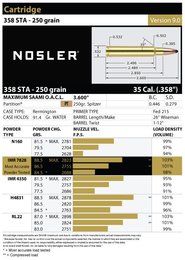

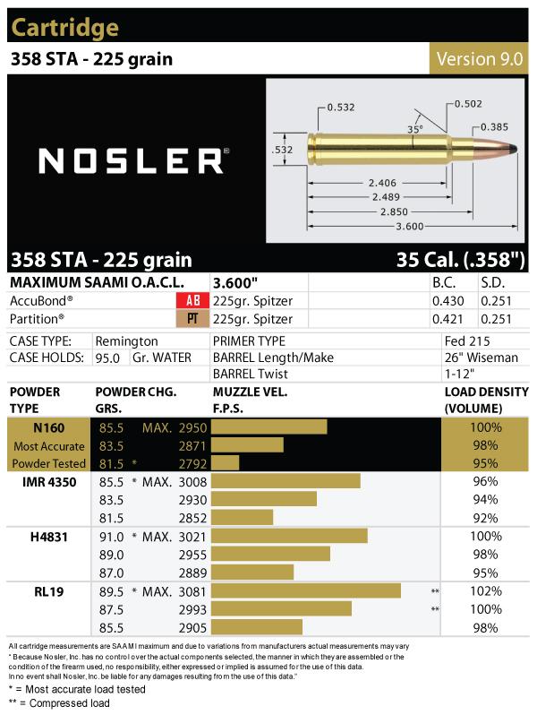

Abbreviated Name:  358 STA
TECHNICAL INFORMATION:
Brass for the “STA” is easily formed by necking-up 8mm Remington Magnum cases in a sizing die equipped with a tapered expander ball. To fire-form, we recommend reducing our starting load of IMR 4350 by 2.0 grains, and seating the bullet to contact the lands of the barrel. Fire forming in this manner will help prevent the possibility of premature case head separation. For subsequent firings, seat the bullet deep enough to avoid contact with lands (rifling).
