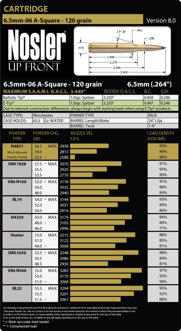

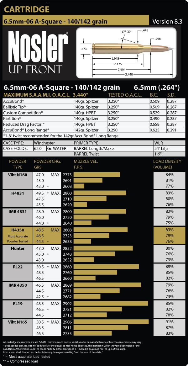

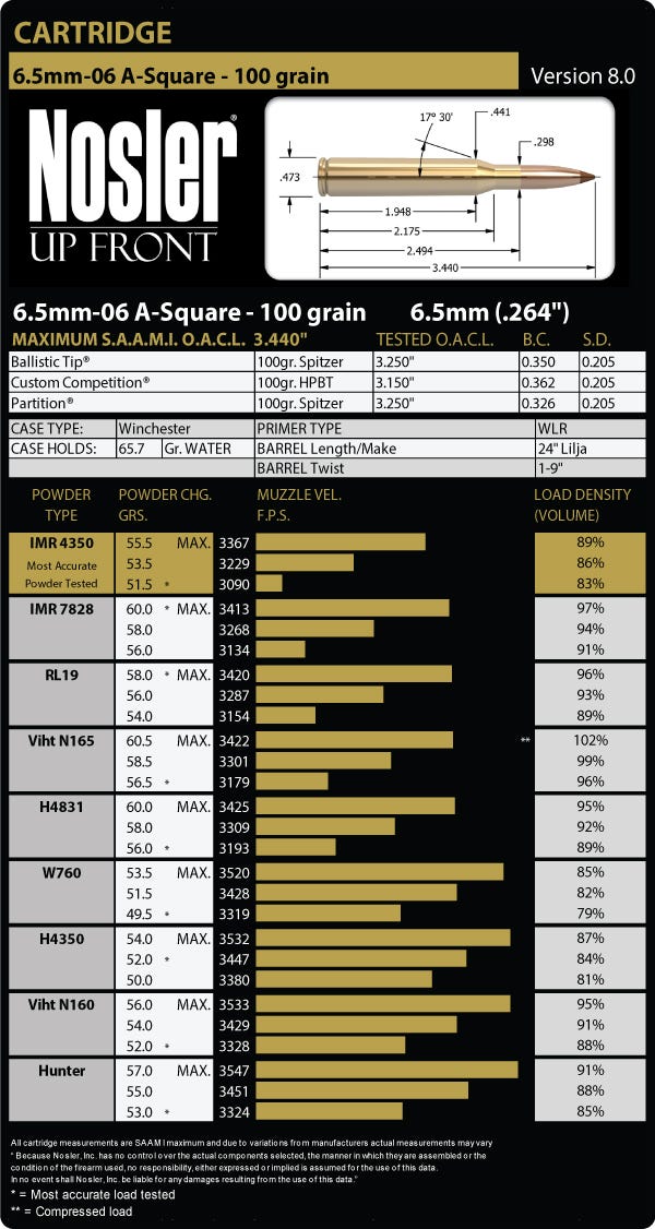

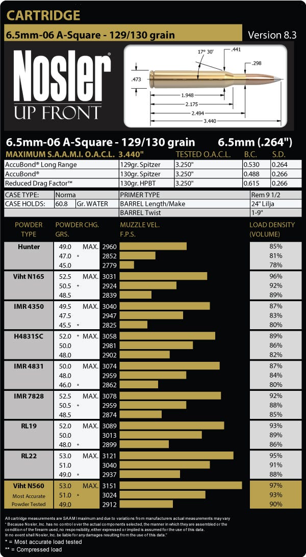

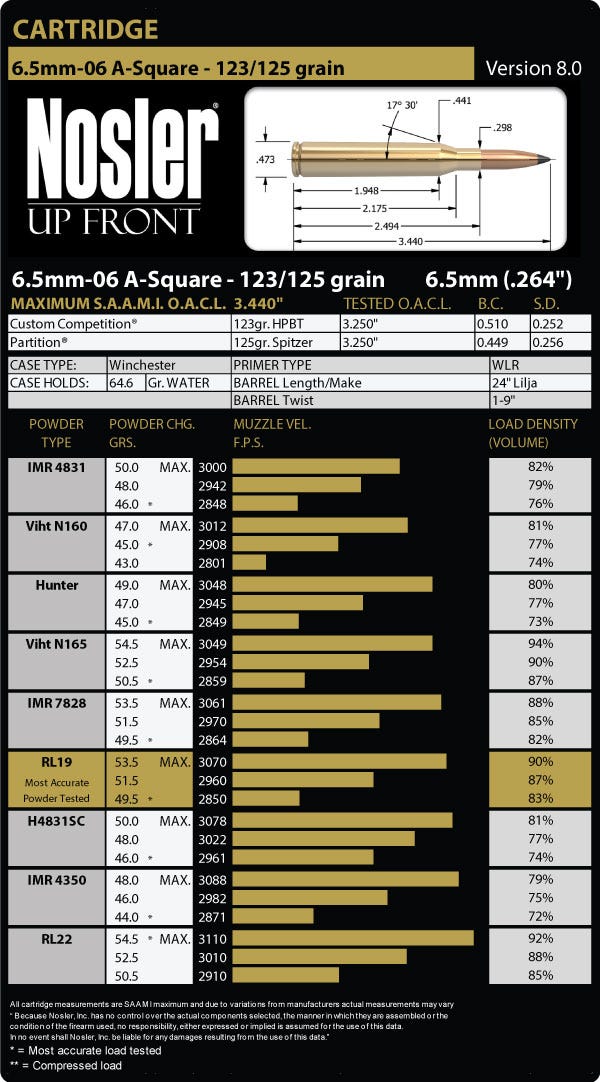

TECHNICAL INFORMATION:
Since the 6.5mm-06 A-Square is a true “wildcat” cartridge, variations in chamber dimensions are likely. We suggest starting with the mildest load listed, and working up in half grain increments. Always watch for visible signs of pressure as you increase your charge weight. NEVER exceed the maximum loads listed in load data. S.A.A.M.I. approved this cartridge in 1999.
