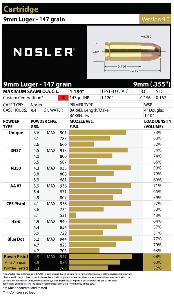

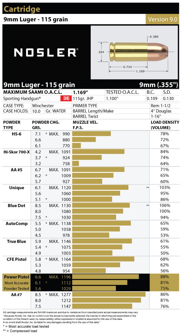

TECHNICAL INFORMATION:
Like most pistol cartridges, the 9mm headspaces on the case mouth. When loading for this cartridge, bell the case mouth just enough to reliably guide the bullet into position and then secure the bullet with a taper crimp. Using this seating and crimping technique will help ensure proper headspacing.
The S.A.A.M.I. overall cartridge lengths for this cartridge are 1.000” min. and 1.169” max. We suggest seating on the higher end of this range, provided that the longer rounds will function well in your particular firearm.
Our load data is not +P rated and does not exceed the parameters for standard 9mm Luger pressures.
