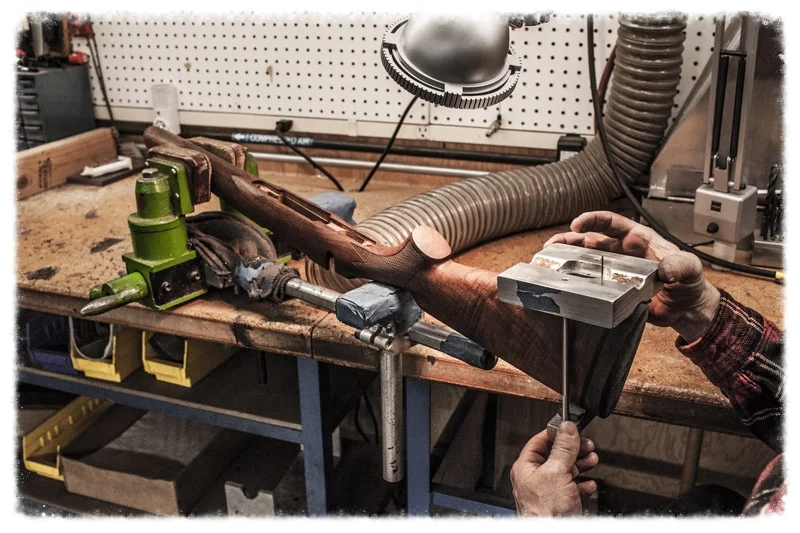

Nosler Stocks
The stocks chosen for our rifles are designed for natural shouldering and point of aim while maintaining classic lines and comfortable recoil dispersion. Synthetic stocks are lightweight and provide consistent performance under harsh conditions, while the wood stocks feature a hand-rubbed oil finish for durability, easy maintenance and a warm, traditional feel. Nosler actions are glass and pillar bedded by hand to their stock to ensure there is a perfect match between components for the utmost accuracy and support. Each stock is fitted with a soft, 1”® recoil pad and standard quick-detach sling swivel studs.
M48 Patriot, and Outfitter models are fitted with an aramid fiber reinforced composite stock that is both lightweight and extremely durable. An aluminum core provides a consistent foundation to support the Nosler barreled action for exceptional accuracy.
Model 48 Custom stocks are made of hand-laid Kevlar® and Carbon Fiber and feature the Nosler® C2™ finish that resists abrasion, intrusive weather, and cleaning chemicals.
A textured finish provides a solid grip in cold or wet conditions.
Pachmayr® Decelerator® recoil pads are installed on all stocks.
All barrels are fully free floated.
Actions are glass and pillar bedded.
Wood stocks feature 20 line per inch checkering to ensure a sure grip in any condition.
Wood stocks are hand-oiled for beauty and durability.
