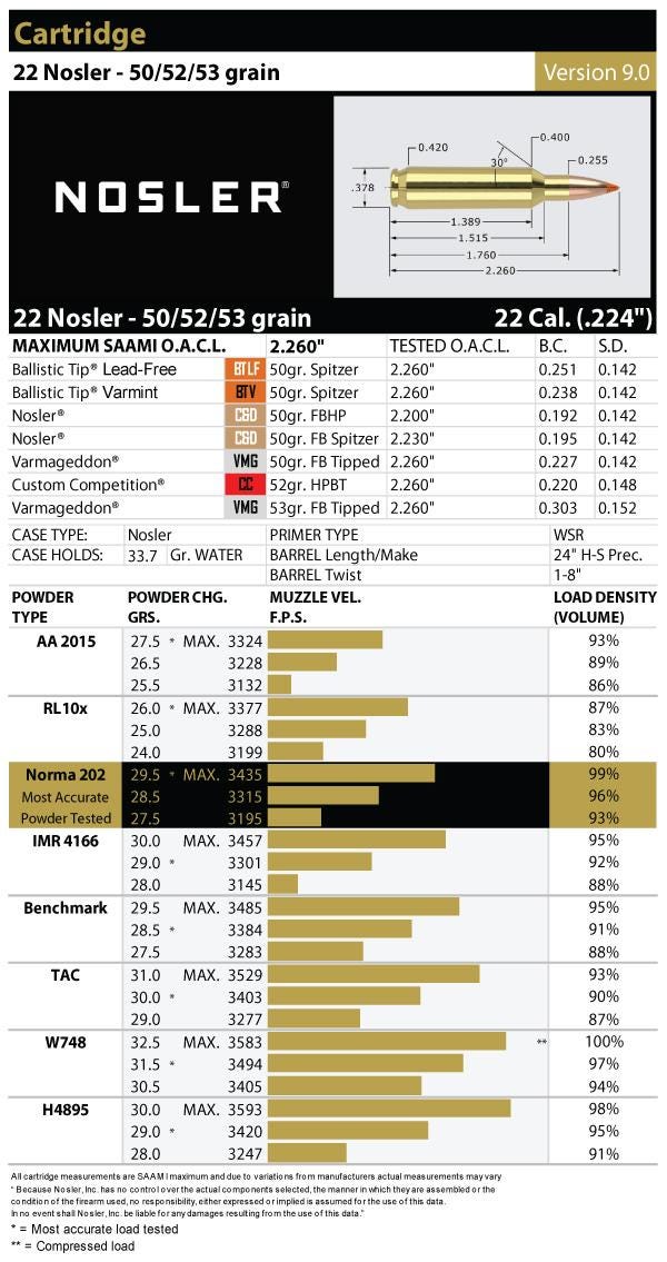

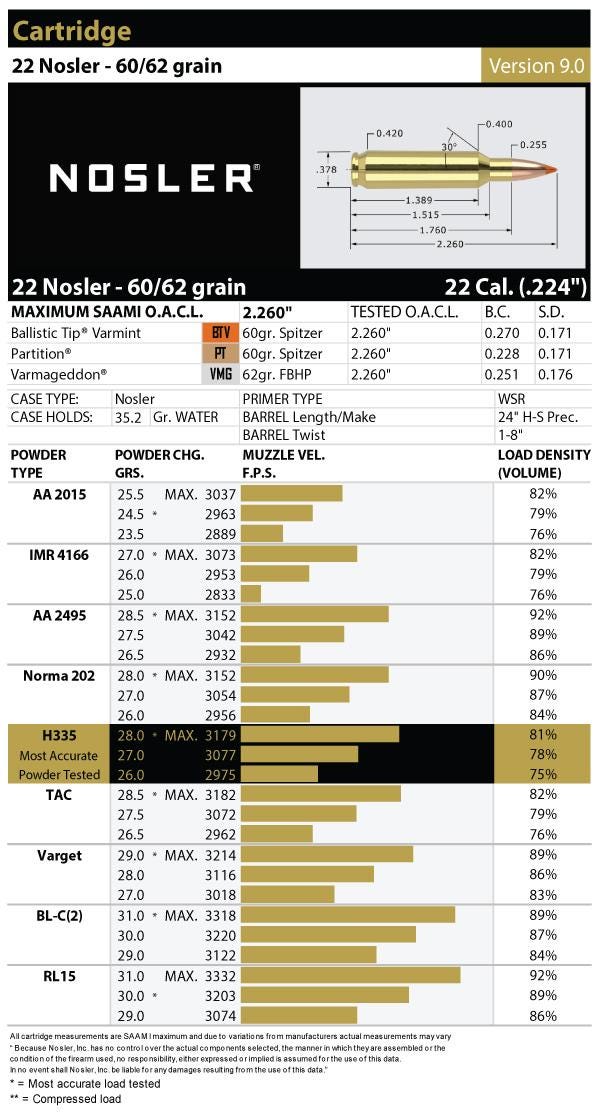

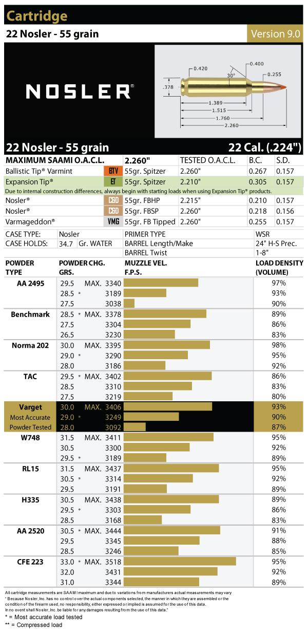

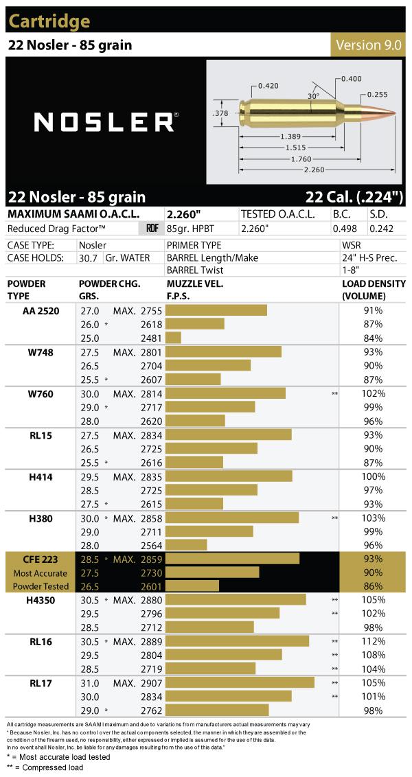

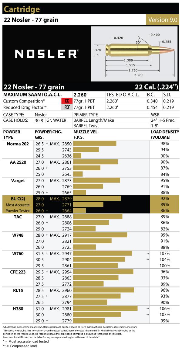

TECHNICAL INFORMATION:
The 22 Nosler case holds 34.2gr H2O at overflow, and 31.2gr H2O with a 55gr Ballistic Tip® seated to 2.260” OAL.  For comparison, a 223 Remington case holds 27.4gr H2O with a 55gr BT seated at 2.260” OAL.  The 22 Nosler has almost 25% more case capacity than the 223 Remington.
Bolt face dimensions are identical for the 22 Nosler and the 223 Remington / 5.56 NATO at .378”.
Barrel Life with all barrels, it really depends on how they are treated but one should see approximately 2,000 rounds as used in competition and as many as 4,000 rounds if used as a plinking rifle.
