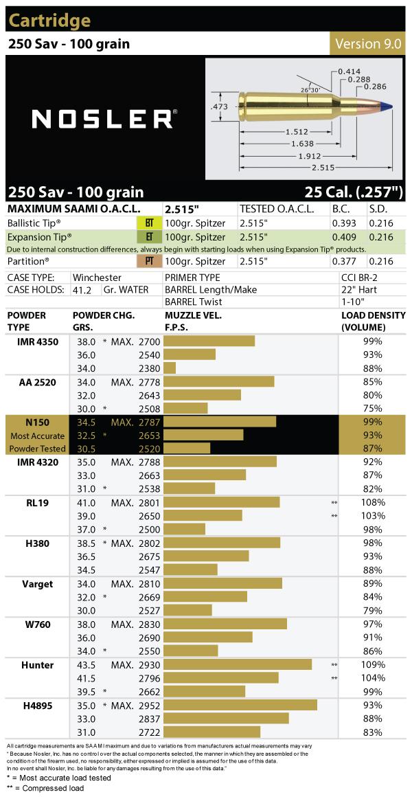

TECHNICAL INFORMATION:

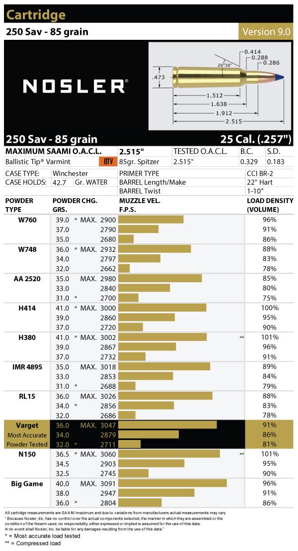

The Savage Model 99 was the original rifle chambered for the 250 Savage. Many older Model 99’ s have a 1-14” twist barrel, and will not stabilize any of our .25 caliber bullets. If your rifle has the new, standard 1-10” twist barrel, it will stabilize all Nosler .25 caliber bullets. The 85 grain Ballistic Tip is a good choice for varmints, but for deer we recommend one of our heavier, 100 grain bullets. As always, when dealing with a lever action rifle, full-length case resizing will yield the best results.
