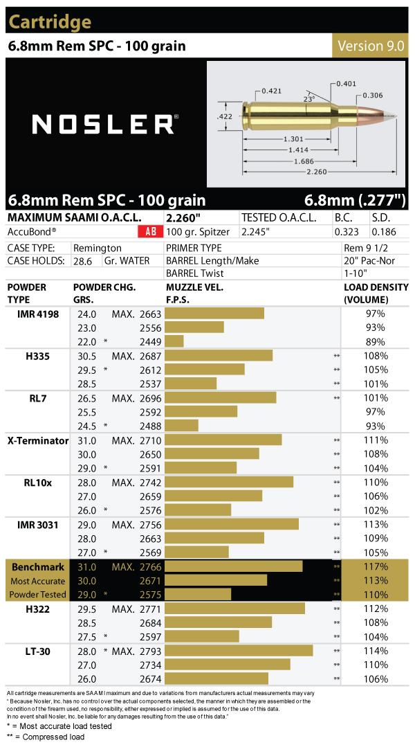

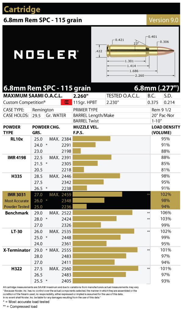

The 6.8 Remington Special Purpose Cartridge was designed by Remington Arms and the USAMU & USSOC as a replacement for the 5.56x45mm NATO cartridge in AR/M-16 rifles. Developed from the 30 Remington rimless cartridge case shortened to function at 2.260” with a .277” diameter bullet, the performance is between the 5.56 and 7.62 NATO rounds. Nosler has developed a line of 6.8 bullets to take maximum advantage of the cartridge’s potential from targets to hunting medium game. While there are other variants of the cartridge developed by custom rifle makers, our load data is for the SAAMI standard 6.8 SPC cartridge. IMR3031 and H322 powders provide excellent performance with all bullet weights.

  • 6.8mm 100 Grain
  • 6.8mm 110 Grain

  • 6.8mm 115 Grain
